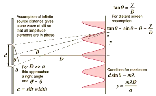

two plane waves
A plane wave hitting two slits will produce interference patterns in the context ( equations and boundary conditions) that they are a solution of. It is not necessary to derive the solutions over and over again since for most interference patterns the plane wave assumption is a good approximation.
The Schrodinger equation is a wave equation , and plane waves are solutions of the equation. Again in the double slit experiments the plane wave solutions are used to model the impinging particles on the two slits, quantum mechanically . The difference between classical plane waves and quantum mechanical plane waves lies in the postulates of the theoretical model used for studying the patterns.
