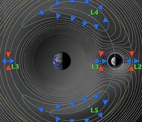

Including the centrifugal potential (see the plot below: credit NASA) in the co-rotating frame and calculating the "L1 point" where the potential is actually maximised, is described here and involves solving a quintic function. However as the moon mass is much less than the Earth mass we can use the "Hill sphere" approximation, that the L1 point is separated from the moon by $r= R (M_2/3M_1)^{1/3}$, where $R$ is the Earth-Moon separation and $M_2/M_1$ is the Moon/Earth mass ratio. Putting in the numbers gives $R-r=$323,000 km, so this is not a small correction.

Representation of the Earth-Moon potential including centrifugal potential (Credit:NASA)
