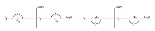

We encounter a singularity at $p^0 = \pm \sqrt{p^2+m^2} = \pm E_{p}$. We can choose a contour which avoids these by dipping below the first, and then above the other. However, to apply the residue theorem, it must be closed. For $x^0 > y^0$, we close it in an anti-clockwise direction in the upper-half plane, and the opposite if $y^0 > x^0$. Alternatively, we can define the Feynman propagator,
$$\Delta_F = \int \frac{d^4 p}{(2\pi)^4} \, \frac{i}{p^2-m^2 + i\epsilon} e^{-ip\cdot (x-y)}$$
The $i\epsilon$ prescription due to Feynman shifts the poles by an infinitesimal amount away from the real axis; as a result the integral going straight through the real line is equivalent to the aforementioned contour.
Depending on your purpose, it may be useful to pick a particular contour, in which case we can define the retarded propagator $\Delta_R$ as the one which chooses to go over each pole on the real line, and the advanced contour going under. See the depiction below:
