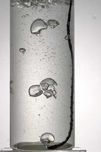

Rising bubbles of air in a liquid oftentimes are anything but spherical.
These bubbles have haphazard shapes because they are rising and because they are interacting with other nearby bubbles. The combination of drag, turbulence, and mutual interactions prevents those bubbles from taking on a nice, simple spherical shape.
