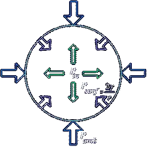

The pressure acting on a bubble pushes on it. The bubble must move into the shape with the least pressure acting on it. The bubble, however, must maintain a constant volume. The shape with the smaller surface area for a constant volume is a sphere (the mathematical proof is complex), so the bubble takes on that shape.
