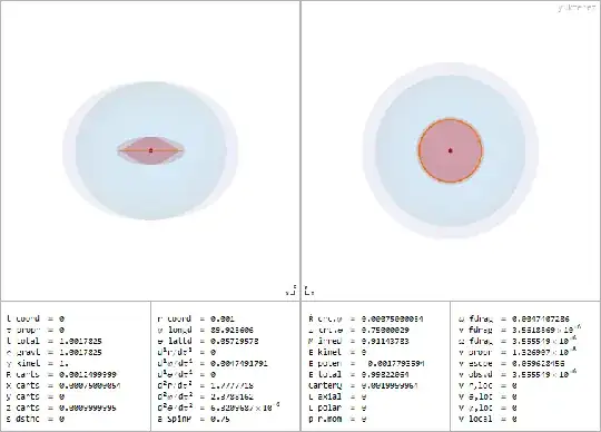

The particle would be in an unstable equilibrium (there would be no prefered direction if you are at rest), but if it were slightly off center it accelerates outwards (gravity is repulsive there, see the d²r/dτ² in the numeric display). If I start at r=0, θ=0 the particle stays where it is, but if I displace it slightly (r=1/1000GM/c², θ=1/1000rad, v=0) it accelerates outwards.
The escape velocity (to escape the time reversed white hole, see the last paragraph) in the center goes to 0, so a very small displacement is already enough to shoot the particle away. The coordinates used are Kerr Schild (click on the image to enlarge):
black hole off center trajectory
The frame dragging rotation in the center also vanishes, so if the test particle is small enough it may stay in the exact center without spinning, see ω fdrag and v fdrag (angular and true frame dragging velocity) in the numeric display (the local velocity components on the bottom right are relative to local ZAMOs, which are possible inside the inner ergosphere).
The acceleration is always in the positive r direction, since when you pass through the ring into negative space the sign of gravity is reversed. So if the displacement is in direction of the negative space you still get accelerated in the direction of positive space.
