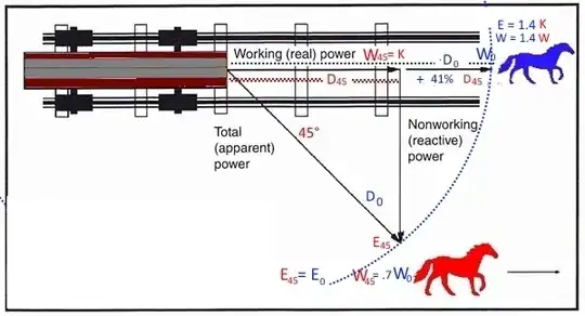

Suppose you are pulling a weight along a track at an angle (in the picture 45°).
If the object is dislocated by a distance $D_{45}$ let's assume that the mechanical work done on/energy transmitted to the object is: $$ W_{45} = (\vec{F}\cdot\vec{d} = Fd\cos_{45}) = K J$$, which in the picture is called: working (real) power.
If you had pulled along the track, presumably the distance covered by the object would be $D_0$ = $D_{45} /cos_{45}$ and the work done would be $$W_0 (= E_0) = (\vec{F}\cdot\vec{d} = Fd\cos_{0}) = K/cos_{45} = K * 1.41 J$$, which in the image is called: total (apparent) power
If this is correct, can we legitimately suppose that the same amount of energy/calories were burned in both cases, that is: $E_0 = E_{45} = 1.41 * K$, but, since the work done is less, that is: ($W_{45} < W_0 = 0.7* W_0$) can we therefore conclude that the energy wasted in the first case (calories burned doing no mechanical work) is 41%? That energy was wasted trying to dislocate the track or derail the cart: non working (reactive) power
(If this is not correct, how can we calculate the energy wasted when we apply a force at an angle greater than 0°?)

Let's zoom in on the horse to look at the forces being applied and the distance moved:
Horse
The force on the train is $F\cos\theta$ so when the train moves a distance $d$ the work done on the train is $Fd\cos\theta$.
It's certainly true that the horse is exertiong a force $F$ that is greater than the force on the train, and the horse also moves a distance $d$. But remember that work is given by:
$$ W_{train} = \vec{F}\cdot\vec{d} $$
where the force $\vec{F}$ and the distance $\vec{d}$ are vectors and the $\cdot$ is the dot product of the two vectors. The dot product is defined as:
$$ \vec{F}\cdot\vec{d} = Fd\cos\phi $$
where $F$ and $d$ are the magnitudes of the vectors and $\phi$ is the angle between the vectors. In our case the angle $\phi$ between the vectors is $\pi - \theta$, so the work done on the horse is:
$$ W_{horse} = Fd\cos(\pi-\theta) = -Fd\cos\theta = -W_{train} $$
The work done on the horse is equal and opposite to the work done on the train, or to express this in a more obvious way the work done by the horse is equal to the work done on the train.
So no mechanical energy is being wasted by pulling at an angle.
However this overlooks the fact that muscles are inefficient things and consume energy even when no mechanical work is being done. This does indeed mean the horse will use more energy to pull the train at an angle, but this is just down to way muscles work rather than fundamental physics. To calculate the extra energy the horse uses you'd have to go off and ask a biologist about muscle physiology.

The key problem in your analysis is this mistaken assumption:
No, you cannot assume that. If you developed an efficient machine for pulling (instead of a horse which is very inefficient) then it would burn less energy in the "diagonal pull" case.
