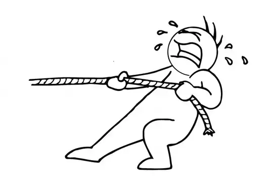

In order to pull a weight you need a rope and a firm grip on the ground. Suppose this last problem is solved 100% (like in the second picture) preventing the feet from slipping. The rope is perfectly horizontal, suppose the man's weight is 100kg. The angle may be between 0° and 45, at your choice. Now, you can decide you want to keep:
  1. your leg(s) firm and stretched and apply your force to the rope pulling it like in this picture. Sketch of man pulling something
    Suppose you are exerting a force (on the train) of 300 N, how much force is going to the train and how much is going to the ground ? and, how much energy is being wasted? Is it possible to improve the percentage of energy which is actually transmitted to the train? (without tricks or external factors)

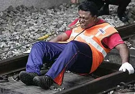

  2. You can stand (like in this picture but holding a rope in both hands) with bent knees and keep your arms stretched. Then you stretch your legs and apply a push on the ground, in this case you are exerting 300N directly on the ground and indirectly on the train , as the displacement of your trunk will pull the train.
    Of course this position is most favourable a): because the legs are usually stronger then the arms [probably, force is more than double here] b): because the angle is near 0°. That's why this man can pull a train!:

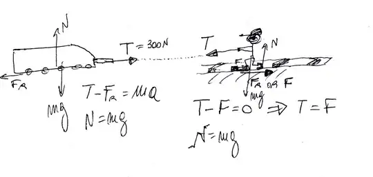

The pulling force isn't somehow split between the train and the ground. The rope will pull with the same force on whatever is holding each end. If the rope is pulling on the train with 300 N, then the man is pulling on the rope with 300 N, and the man must be pushing on the ground with a force of 300 N laterally. The vertical component of the force the man is pushing on the ground with will be his weight plus some fraction of the pulling force depending on the angle of the rope.
If the rope is horizontal, then no part of the pulling force results in vertical force on the ground. In this case, which is pretty close to your bottom picture, the horizontal component of the force on the ground is equal and opposite of the force the rope is being pulled with, and the vertical component is simply the man's weight.

Notice that the man in picture 2 is practically horizontal: this means that the force of his legs is transmitted to the shoulders through compression of the spine, rather than by tension in the back muscles. In the latter case, you probably know from experience (and could demonstrate with a simple diagram) that tremendous forces appear on the back muscles when your back is not straight when you lift - up to 7x the weight lifted (because the muscles run close to the spine, so the lever is very short). The man in picture 1 creates a torque along his back - and the back muscles have to provide the counter torque.

Looking again at your picture 2 - it is clear that the man in the picture "knows his physics"; even if he might have come to the above conclusion empirically, you see almost all the elements of my solution in his posture (except that in order to use his mouth, he has to arch his back somewhat. I think he could pull more if he used his hands. Just sayin').

I believe that a simple drawing can clarify some of the misconceptions. In dynamics, you must analize the forces acting on the individual objects separately. I have drawn the forces on the train and on the person:
You can see that if the person is not moving the floor must do a force equal to the tension. The internal forces inside the person do not matter here. they are internal. What is the best angle for the rope? one which allows the person to make the largest internal force. Also important, the angle on the rope will change the horizontal component of the tension to make it smaller, but it will also will diminish the friction force on the train because it will reduce the normal force N. What is the perfect angle depends on the coeficcient of friction, that is, if there is an angle such that the net horizontal force on the train, $F_x=T_x-F_r$, is maximal. That is, find the angle $alpha$ that makes maximal the horizontal force on the train:
$F_x=T(\cos \alpha + \sin \alpha)-\mu m_{train}g$
