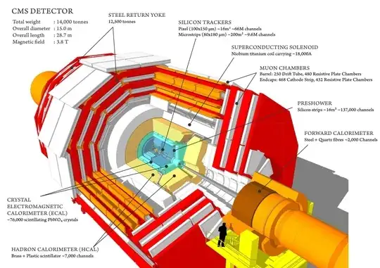

cms
This is the CMS detector.
The complexity of the LHC detectors requires these enormous collaborations of 3000 people working on one goal : getting physics data out of the system. Algorithms are a necessary part of this chain and are made to order using the basic physics concepts that drive the detectors. An example of the complexity and the continuous upgrading and improvement of the algorithms entering the analysis are the ones for defining and measuring a jet.
As Curiousone says in order to understand the algorithms entering in the data reduction from these detectors a lot of elbow grease is needed. Certainly they are custom made.
