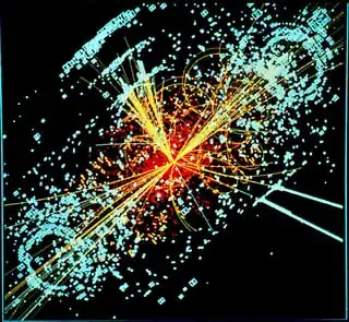

My understanding is that much of the data that is is collected at the Large Hadron Collider is similar to that in the image below, and that a vast amount of the data contains little of specific and immediate interest.
My understanding is that data is recorded at 700 MB/s and about 15 PetaBytes are collected per year.

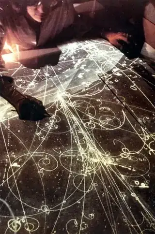

I assume this is too high to be examined manually, like the second image here shows.
What automated methods are used by physicists to cull the vast amount of data collected and find results that are of interest?

The second picture is from a bubble chamber and life was then simpler because the recorded data of the event were there. The first picture is from a detector experiment and to get at the image already programming has been used so that an image of track can be given in the computer. See this Atlas talk of how they detect and identify a track, to understand that your question can only be answered by hand waving, since after having a reconstructed event with many tracks further decisions have to be taken for physics analysis.
