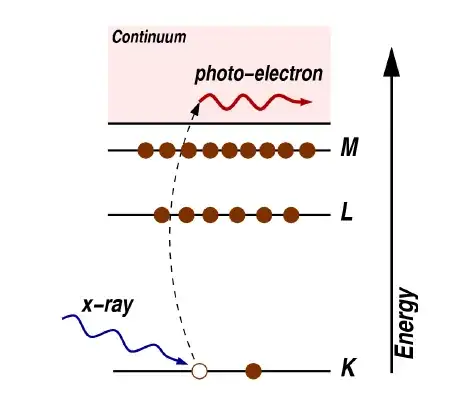

Well it may help to first simply consider the famous the photoelectric effect, and see how photon frequency $\nu$ is related to the photoelectron's kinetic energy, once you are sure you understand up to this point, then we can move on to your question on photoelectric current. enter image description here
The picture is a typical diagram used to elaborate on the photoelectric effect, where the photon's energy $h\nu$ has to be larger than the electron's binding energy to its atom usually denoted as work function $E_0$, only then a photoelectron is created. As for its kinetic energy, just make use of the Energy Conservation in photoelectric effect: $$h\nu = E_0 + \frac{\hbar^2 k^2}{2m} $$ where the second term in the right hand side is the kinetic energy, $h$ Planck's constant, $m$ mass of the electron and $k$ its wavenumber (momentum $p=\hbar k$)

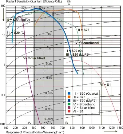

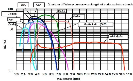

The probability of a photocathode to emit an electron upon incident photon is called quantum efficiency. Contrary to your intuition, it is relatively constant for the range of wavelengths to which the photocathode is sensitive and it drops quickly outside of this range, see the picture below (taken from Hamamatsu webpage). Quantum efficiency of various photocathodes
I don't know if this property is true for all other materials - it is possible that people specifically looked for materials with flat photoefficiency spectrum to be used as photocathodes.
When you consider photocurrent produced per unit of light power, indeed, you have to take into account that there are less photons per Watt for shorter wavelengths. See how photo sensitivity look like when plotted on mA/W scale and note black curves of constant quantum efficiency:
Photocurrent vs wavelength (source)
