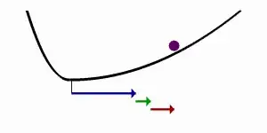

I made this little animation for wikipedia a few months ago, partly to clarify this very issue...
Electron asymmetric motion animation
An electron (purple) is being pushed side-to-side by a sinusoidally-oscillating force, i.e. the light's electric field. But because the electron is in an anharmonic potential energy environment (black curve), the electron motion is not sinusoidal. The three arrows show the Fourier series of the motion: The blue arrow corresponds to ordinary (linear) susceptibility, the green arrow corresponds to second-harmonic generation, and the red arrow corresponds to optical rectification.
Since you're asking about second-harmonic generation, let's focus on the green arrow.
In an inversion-symmetric crystal, there are two possibilities for each electron.
(A) Many of the electrons are in an inversion-symmetric local environment. So imagine that the black curve for this electron is symmetric, the same on the left vs the right, rather than lopsided like the one I drew here. If you think about it, there cannot be a green arrow in that case. Try to visualize why. The green arrow is guaranteed to cause lopsided, asymmetric motion.
(B) The rest of the electrons are paired up, where one electron has a curve that's lopsided to the left, and its sibling has a curve that's lopsided to the right. The green arrows for those two electrons would be opposite at every moment. So the second-harmonic radiation from one of these electrons would exactly cancel out the second-harmonic radiation from its sibling.
By the way, the same argument applies to optical rectification (the red arrows). It doesn't happen in an inversion-symmetric crystal. And same for fourth-harmonic generation, sixth-harmonic, etc.

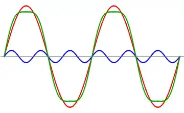

If the medium has inversion symmetry, then the response of the medium is the same regardless of orientation. The degree of polarization in the "positive" direction is the same as the "negative". The polarization response crosses zero symmetrically, right in the middle of the excursion. The excursions of the polarization are the same in the positive and negative directions. The Fourier components of the disturbance can have only odd-order contributions. The lowest order harmonic generation in such systems is third harmonic generation.

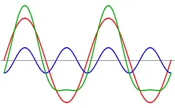

When the medium lacks inversion symmetry, the excursions in the positive direction differ from those in the negative direction. The response is not symmetric: the zero crossings are not symmetrically placed, and the excursions on either side of a zero crossing are not the same. This results in even order contributions to the Fourier components.
A picture is worth a thousand words here. Here's one from Wikipedia, but I have to admit it's not easy to understand. There is a great picture somewhere ... I've re-drawn it myself many times. If I find a link to it I'll update the answer.
update
Look here It's an improvement, but there is a better one out there somewhere. The thing to note in this article is that the asymmetric response is the sum of the second harmonic, fundamental, and DC components.
