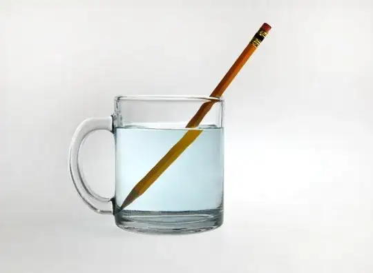

The picture of the refraction of the pencil part inside the water cup, is exactly the result of this effect. Because light inside the water (which has a different refraction index than the air), makes the light take another path in order to minimise the time the path takes.
