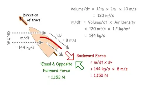

There's a simple way to estimate the force generated by a sail when sailing into wind, using Newtonian mechanics based on the mass flow rate; using the equation: Force = ma = m/dt x dv.
