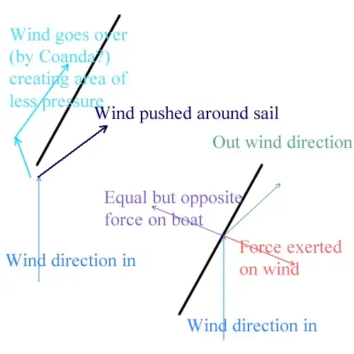

Diagram of the air flow
This is my attempt at how this translates into sail. The air is pushed around the sail, which exerts a force (in purple) on the boat. However, I can see no way for this force to be into the wind.

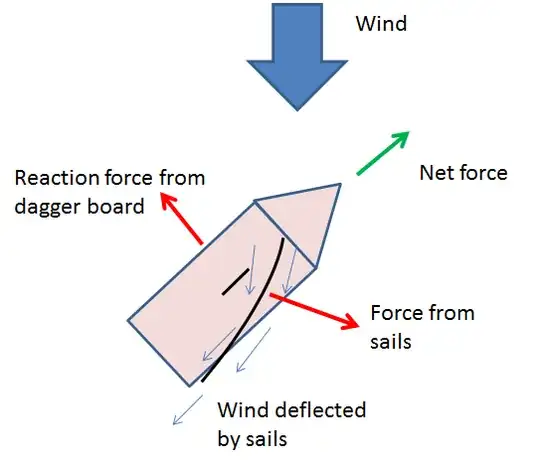

Newtonian Aspect
So the force generated by the sail will perpendicular to the sail. This is because only the momentum of the air particles perpendicular to the sail changes the component changes the component along the sail is unchanged.
However, most sailing boats have a daggerboard or keel under the boat. Essentially this is a big plank under the boat in the water which provides a large resistance to any lateral motion (also helps prevent capsizing). Therefore the net force is forwards.
See my impressive paint skills.
