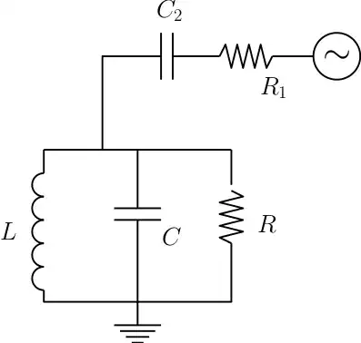

I know that for parallel RLC circuits, the $Q$ factor is given by:
$$ Q = R \sqrt {\frac{C}{L}} $$
But now suppose it is connected in series to a resistor $R_2$ and capacitor $C_2$. Would the $Q$ factor be changed?

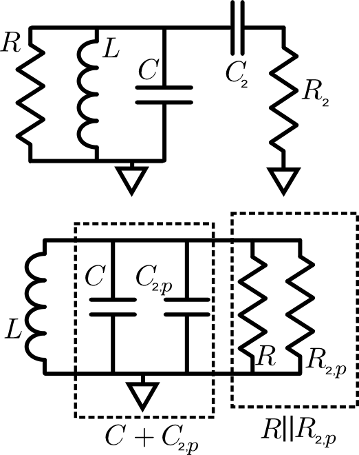

The idea is to turn the series branch $C_2$, $R_2$ into an effective parallel $R$ and $C$. See the diagram. The effective parallel values are denoted $C_{2,p}$ and $R_{2,p}$. Parallel capacitances just add, so the total capacitance is now $C+C_{2,p}$. Parallel resistances add in parallel so the total resistance is now $R||R_{2,p} = \left( 1/R + 1/R_{2,p} \right)^{-1}$. Since we now have a purely parallel circuit, you can stick these values into your formula for $Q$ (which was wrong in the OP, by the way, but I edited it).
Of course, to actually do any of this we have to understand how to solve for $R_{2,p}$ and $C_{2,p}$.
