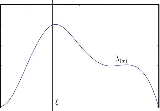

We only care about the mass distribution of a person along one axis $\lambda_{(x)}$. So the person is laid down (along the radius of our rotating table) and the axis at some distance $\xi$ from the head (or feet doesn't matter). Below a schematic representation: enter image description here
If we knew $\lambda_{(x)}$ we could calculate the angular momentum $L_{(\xi)}$ for this case as:
$$L_{(\xi)}=\int_0^l \omega (x-\xi)^2 \lambda_{(x)} dx$$
where $l$ is the length of the person (the height). Let us put $g_{(x-\xi)} = \omega (x-\xi)^2$ which yields
$$L_{(\xi)}=\int_0^l g_{(x-\xi)} \lambda_{(x)} dx = g \ast \lambda$$
the convolution product these two functions, so we will have
$$\mathcal{L} L_{(\xi)} = (\mathcal{L} g) (\mathcal{L} \lambda)$$
$$\lambda = \mathcal{L}^{-1} \left( \frac{\mathcal{L} L}{\mathcal{L} g} \right)$$
Where $\mathcal{L}$ and $\mathcal{L}^{-1}$ are the direct and inverse Laplace transformation operations, which are more convenient for this case.
So now we have a formal expression for $\lambda_{(x)}$, and integrating it through any segment of the body, will give us the mass contained in it.
