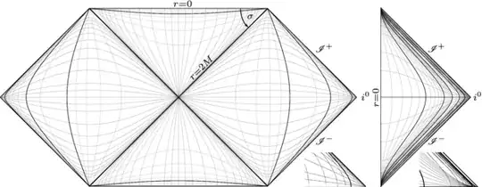

This can be nicely seen on Carter-Penrose diagrams which organize the space-time so that direction forward in time is just "up" on the diagram (up to a deviation of 45 degrees). You can see in these that from $r=2M$ we can go just "up" in the black hole. (It is however slightly complicated to understand them, so maybe stick with the previous paragraphs.) enter image description here

You can get an intuition for this by looking at the picture below. Once we see ultimate causal time-directions (this is a very loose image) pointing towards a center like this, they will have to cross and merge into a singularity. But do they really have to? We are in a curved space-time - the space could "curve out" and continue infinitely in the direction outside our flat screen and the time directions would never cross. However, positive mass and energy always act on space so that this is precisely a shape that cannot be caused by it.
So to conclude, by a "trick" using geometrical analysis it can be shown that physical matter just cannot in principle "construct" a space-time so that a "causal merger", a singularity, isn't contained in the space-time.
