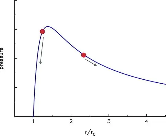

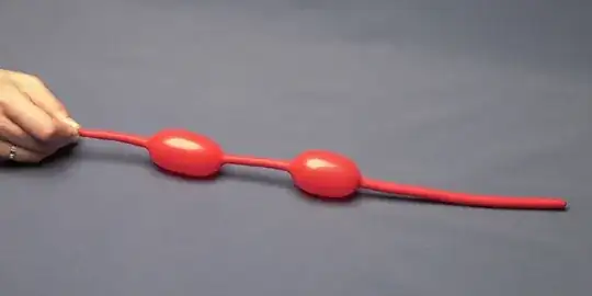

The material of an unstretched baloon does resist stretching; this can largly be overcome by manually pre-stretching it (something I learned from my mom when I was about 5 years old). The other thing I'd consider (and that I don't see mentioned so far) is the cumulitive force exerted on the inner surface of the baloon as it's inflated, calculated by Pressure x Area. Example: a 2" diameter round baloon has in surface area of about 50 sq in. at 2 pounds sq in, that's 100 pounds of force total. At 4" diameter, it has about 200 sq in; at the same 2 pounds per sq in, that's now 400 pounds of force total. The difference in the force is the square of the change in diameter.
The pressure curve for a rubber balloon , summarized in the Wikipedia article Two-balloon experiment, derives the pressure using a theoretical stress equation based on the thermodynamic theory of elasticity for an ideal rubber. They find the approximate formula $$P= \frac{C}{r_0^2 r}\left[1 - \left(\frac{r_0}{r}\right)^6\right]$$ where $r_0$ is the balloon's uninflated radius. https://upload.wikimedia.org/wikipedia/commons/thumb/8/82/BalloonPressureCurve.jpg/584px-BalloonPressureCurve.jpg

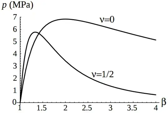

This lecture uses the "two-dimensional, plane stress generalized Hooke’s law with respect to the Eulerian strain measure" (which they call a a very rough approximation) to derive a curve ($\nu = 1/2$ for incompressible).
Both derivations take into account the thinning of the (assumed incompressible) rubber as the membrane stretches.
