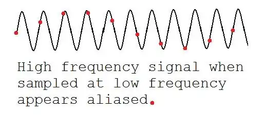

This is a type of aliasing problem. As with the usual aliasing, the problem at $\pm \pi/a$ goes away when one makes the sample rate faster, that is, replaces $a$ with a smaller value. And just as with aliasing, making $a$ smaller does not eliminate aliasing entirely, but instead pushes the problem to a higher frequency.
This drawing shows the usual aliasing effect. Note that the high frequency black signal (which corresponds to a high momentum) appears as a low frequency red signal (with low momentum):

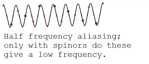

So consider what happens for a frequency a little larger than $\pi/2$. In the following illustration we color every other sample red or blue:
In the above, the density matrix will see this frequency appropriately as a high frequency. But with a spinor, we have arbitrary complex phase freedom. So we can negate the blue dots; the result is a low frequency. Thus the arbitrary complex phases of spinors naturally give aliasing problems at half frequencies.
