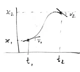

This is a very heavily constrained problem - and it sounds a lot like a spline fitting problem. As you may know, a spline is a curve that has continuous third derivative - and as a side effect, it minimizes the curvature as it connects points. In this case, the problem would then be re-stated as a spline that goes through the two points given, with the slope given. The smoothest acceleration / deceleration would follow from that spline fit.
So if we draw a diagram:
We can see that a spline may well be what you are after. So - how do we solve the set of equations? We know the spline should be a cubic - and it so happens we have four constraints:
position at t1
position at t2
velocity at t1
velocity at t2
I am sure you can solve four equations with four unknowns… but if you can't, let me know and I will try to write the solution later tonight. Or Google "spline fit".

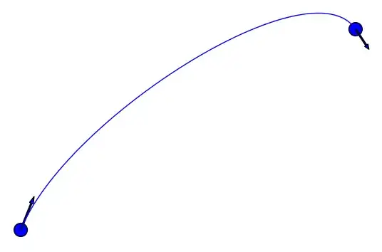

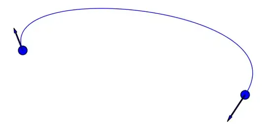

I was thinking you could do a Bezier curve inspired approach (but with quadratic interpolation instead of linear interpolation). You know that at the beginning of time you want the path to look like $$ p_0 + v_0 t $$ and at the end of the trajectory you want it to look like $$ p_f + v_f (t-T) $$ So, let's try to smoothly interpolate between these two trajectories. In order to not screw up the derivatives, we will interpolate between them with a quadratic obtaining a function of the form $$ f(t) = \left( 1 - \left(\frac t T\right)^2 \right) ( p_0 + v_0 t ) + \left( \frac t T \right)^2 \left( p_f + \alpha ( t - T ) \right) $$ Where I have left $\alpha$ because that will be determined by setting the derivative at $t =T$ equal to $v_f$, giving us $$ \alpha = v_f + 2 v_0 + \frac 2 T ( p_0 - p_f ) $$
Using this interpolation, we get paths that look pretty good as far as I can tell, for example in two dimensions we get things that look like: an example trajectory
or:
another example trajectory
This should be equivalent to the other cubic approaches mentioned.

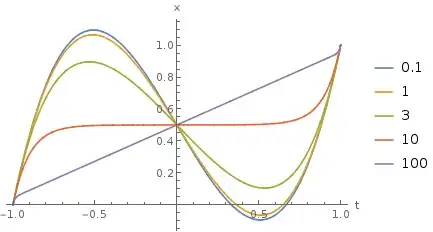

Adding kinetic energy cost
As another alternative, I was thinking about this problem some more, and if you want to try to prevent some of the retrograde motion, it would help to add a cost term proportional to the kinetic energy of the path as well. This ought to lead to paths that are more physical, turning the problem into one more like traditional trajectory optimization. So in particular, we try to minimize the objective: $$ S = \int dt\, \frac{\alpha^2}{2} \dot x^2 + \frac 12 \ddot x^2 $$ subject to the constraints $$ x(-1) = x_0 \quad x(1) = x_f \quad \dot x(-1) = v_0 \quad \dot x(1) = v_f $$ it will be convenient for me to imagine time as running from $t=-1$ to $t=1$. Since this objective is quadratic we can solve it exactly with variational calculus, just like Qmechanic did for the case that minimizes just the acceleration. Taking a variation, we obtain $$ \delta S = \int dt\, \alpha^2 \dot x \delta \dot x + \ddot x \delta \ddot x $$ and we can integrate by parts and obtain $$ \delta S = \int dt\, \left( \ddddot x - \alpha^2 \ddot x \right) \delta x = 0 $$ which gives us an ordinary differential equation for $x$, which we can solve. Notice that for the acceleration the diff eq is the equation for an exponential. To make it slightly easier to specify the solution I'll choose $\sinh$ and $\tanh$ for the solution basis. $$ \ddot x = A \sinh(\alpha t) + B \cosh(\alpha t )$$ which we can integrate twice to get the position itself. $$ x = \frac{A}{\alpha^2} \sinh(\alpha t) + \frac{ B}{ \alpha^2 } \cosh(\alpha t) + C t + D $$ and our boundary conditions give us the solutions for $A,B,C,D$, we obtain $$ B = \frac{ \alpha \Delta v}{2 \sinh \alpha} $$ $$ D = \bar x - \Delta v \frac{ \coth \alpha }{ 2 \alpha } $$ $$ A = \alpha^2 \frac{ \bar v - \frac 12 \Delta x }{ \alpha \cosh \alpha - \sinh \alpha } $$ $$ C = \frac{ \frac \alpha 2 \Delta x \cosh \alpha - \bar v \sinh \alpha }{ \alpha \cosh \alpha - \sinh \alpha } $$ where $$ \Delta x = x_f - x_0 \quad \bar x = \frac 12 ( x_0 + x_f ) $$ $$ \Delta v = v_f - v_0 \quad \bar v = \frac 12 ( v_0 + v_f ) $$
As an example, below I show the trajectories that result for $\alpha \in ( 0.1, 1, 3, 10, 100 ) $ for $ x_0 = 0, x_f = 1, v_0 = 5, v_f = 5 $. This is an example for which minimizing the acceleration alone results in retrograde motion.
Example trajectories
In the limit that $\alpha \to 0$ we recover the other solutions, and in the limit that $\alpha \to \infty$ our particles just move at constant velocity from one point to the other, with large kicks in the velocity at the start and end.
I thought I'd offer this as another alternative.

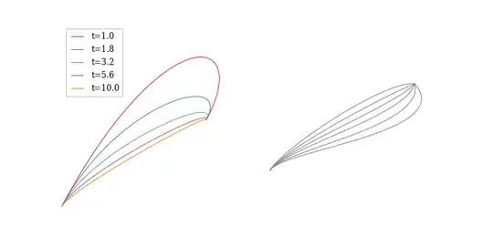

An an example, here: Examples paths by Hobby splines
I show some examples. On the left I show the effect of the tension parameters for fixed initial and final state and on the right I show some curves generated for a tension of 2 as I vary the final velocity.
Based on what you've said I'd recommend a tension of 2 or so.
