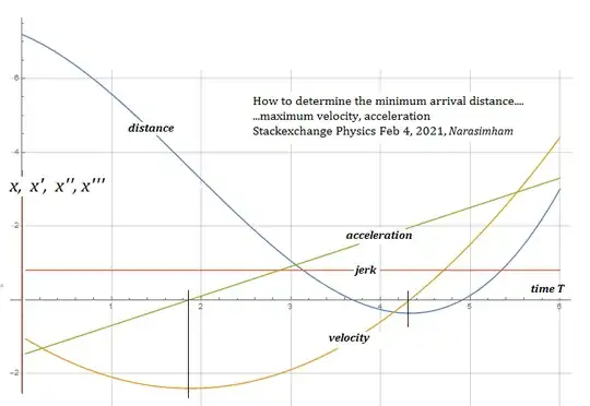

From Maclaurin Series we have the expansion of displacement in terms of its successive derivatives with initial values:
$$ d = d_i + u \frac{t}{1!} + a \frac{t^2}{2!} + j \frac{t^3}{3!} \; \tag 1 $$
Usual notation ( u,v) initial and final velocities ; (a,j) are acceleration and jerk. Time calculation is based on average assumption of start, end values of velocity as average:
$$\text {Time } t=\frac{v-u}{a}\tag2 $$
Eliminating $t$
$$ d = d_i+u \frac{\left(\frac{v-u}{a}\right)}{1!} + a \frac{\left(\frac{v-u}{a}\right)^2}{2!} + j \frac{\left(\frac{v-u}{a}\right) ^3}{3!} \; $$
which simplifies to
$$ d= di+\dfrac{(v-u)}{2a} [(v+u)+\dfrac{j}{3a^2} (v-u)^2] \tag3 $$
Special case of uniform acceleration $ (d_i=0, j=0)$ reduces to a familiar distance formula
$$ 2 a d = v^2- u^2 $$
In the above numerical example arbitrary stop (jerk, acceleration, velocity, distance) values are assumed and corresponding start values are calculated:
[(0.8,0.8),(-1.5,3.5),(-1,4.4),(-6.43768,3)]. Time T is 6 secs.
Maximum velocity occurs at
$$ t_1 = \dfrac{-a}{j}=\dfrac{1.5}{0.8} = 1.875 \tag 4$$
seconds. Maximum velocity can be evaluated. Net step is to plug it into the expression to cast v_max at start at any other desired instant of time.
Shall complete with the full answer soon.
