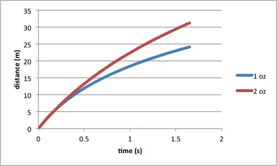

Plotting a graph of velocity and position as a function of time for a 1 oz and 2 oz (nominal) ball, I get for the position:

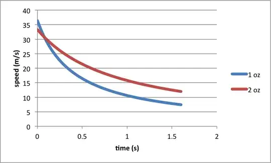

and for the ball speed:
This confirms that the lighter ball will initially go a little bit faster - but that drag will quickly eliminate its advantage over any but the shortest distances. I will add graphs of the above function of x(t) when I get near a computer (hard to do on a phone...)
