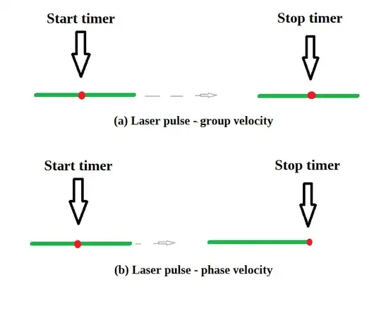

fig.1 Figure 1 Group velocity vs. Phase velocity for a laser pulse
Simply, as shown in fig.1, the phase velocity is derived from the time it takes the front of a laser pulse (i.e. length of pulse can be few mm), to reach the destination target whereas the group velocity is the actual velocity by which each point of the laser pulse moves through space with all the points having the same speed namely the group velocity. When we refer to the speed of photons c=3x10E8 m/s in the laser pulse we refer only to the group velocity with each point of the laser pulse being a photon. When we refer to the whole laser pulse we can choose either its group velocity or its phase velocity. Keep this descriptions and definitions in mind since they will become important to explain the phenomenon later on.

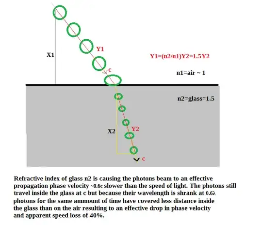

fig.2 Figure 2 Photons traveling at fixed group velocity c inside the transparent medium like glass, are shank in size (i.e. wavelength) therefore the total length but also phase velocity of the laser pulse is reduced by 40% compared to the group velocity of the photons.
As best explained and illustrated in fig.2, the photons transitioning from the much less dense matter field of air to the much more dense matter field of glass as indicated accordingly by their refraction index, undergo a wavelength reduction and shrink in size by 40%. Therefore, their phase velocity and also total length of the laser pulse and its phase velocity are effectively reduced by the same amount 40%.
