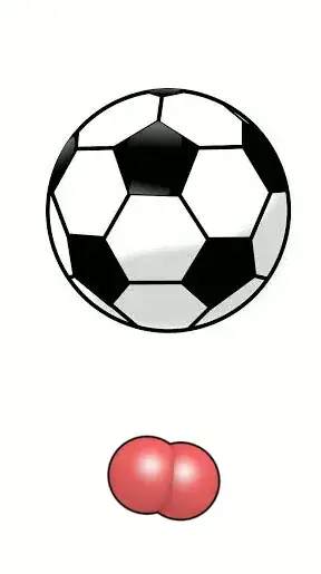

Linear momentum!
I think the easiest way to gasp the concept is to think at atomic level about momentum of the objects and the air's atoms that cause friction.
Linear momentum is equal to $m\times v$ so heavier object have higher momentum. Imagine an atom that comes from the opposite direction of the falling object and collide with the object. enter image description here
For making the things easier we suppose an inelastic one-dimensional collision. Basically when the atoms collide with the object the object lose part of its momentum, mass is constant so this cause the object to slow down.
Imagine two objects with different mass but same velocity, the object with greater mass (e.g. a metal sphere )will lose only a little bit of its linear momentum hence it will keep going with a velocity near to the initial one, in the other hand the object with smaller mass (e.g. a ballon) and hance momentum will lose a great portion of its linear momentum and so it will slow down considerably!
