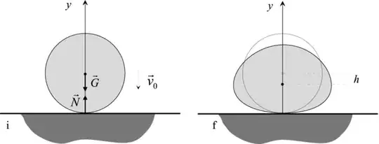

Then we get to the impact. The ball will deform during the impact - the center of mass tries to keep going, but the surface it hits try to stop it. This leads to elastic deformation like this:
(Image credit: http://ej.iop.org/images/0143-0807/34/2/345/Full/ejp450030f2_online.jpg )

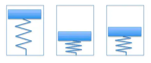

The potential energy of the ball was converted to elastic energy. You can think of it as the mass of the ball being mounted to a spring that compresses when you hit the floor - but there will be some friction (both inside the ball, and particularly between the ball and the floor) which will dissipate energy:
enter image description here.
The picture on the left is the "in flight" state - the spring is uncoiled. The picture in the middle is the "fully compressed" state in which all energy of motion would have been converted to elastic energy. The picture on the right is the "actual" state: the spring did not compress all the way down because energy was lost due to friction (and thus was not available for compressing the spring).

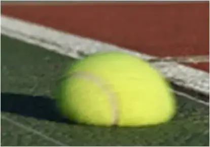

Why do I say that friction between ball and floor is important for vertical impact? Look at this picture:
Image credit: http://deansomerset.com/wp-content/uploads/2011/11/tennis-ball-impact.jpg
This is a tennis ball bouncing on the ground. See how distorted it is? Imagine taking that spherical surface, and pushing it into this new shape. The distortion requires you to change the contact area. As you do so, ball rubs against floor. The lateral force that this generates dissipates heat - so energy is lost instead of being stored in the elasticity of the ball.

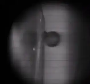

Of course for an air filled ball, there are losses associated with the compression of the air: while the air is (adiabatically) compressed, it heats up; while it is hot, it dissipates heat to the environment; and when it expands, it cools down again. This ought to mean that when you hit a ball it gets cold: but we know that a squash ball, for example, gets HOT, not cold, when you hit it (this is why squash players "warm the ball up" before playing: as it becomes hotter, the pressure in the ball rises and it becomes bouncier). This heating is due to the extreme distortion (and thus again friction) of the ball during impact:
enter image description hereenter image description here
Source: screen shots from https://www.youtube.com/watch?v=5IOvqCHTS7o
