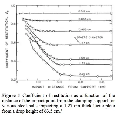

As for the updated question and the "search for the superball": this is tricky, because it takes two to tango in collisions (forgive the mixed metaphor). It's not enough to have a "super ball", you need a "super surface" too. An example of the importance of the surface characteristics is given in "The Effect of the Width of an Aluminum Plate on a Bouncing Steel Ball" - a description of experiments that demonstrate how the coefficient of restitution is a function of the distance from the point of impact to a clamp. A graph from this paper:
shows that just changing the geometry of the clamps holding the plate changes the coefficient of restitution by a significant amount (when the pressure wave from the impact has time to travel to the clamping point and back, more energy is returned to the ball - the plate undergoes less deflection and thus less loss). Unfortunately I have been able to find very little "good" scientific data on coefficients of restitution. It seems that among sports equipment, golf balls are the best (0.83); superballs (polybutdiene) can reach values of up to 0.90 - but their COR is highly temperature dependent.
