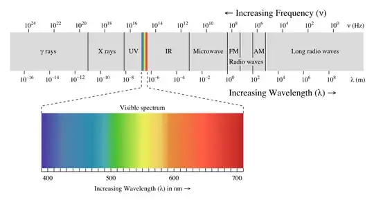

Here's very good image of "light" (light is part of spectrum we see (visible spectrum), full spectrum is called electro-magnetic spectrum, but for simplicity let's call it just light) spectrum:

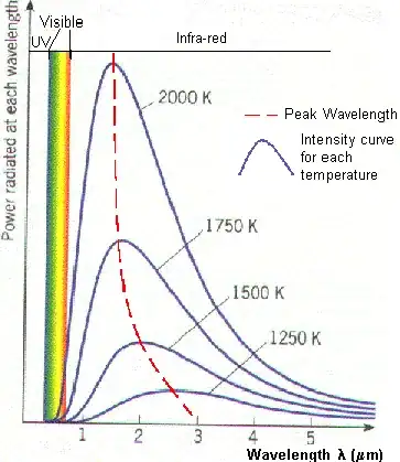

Here's a very good diagram of emitted light with wavelength $\lambda$ from an object with temperature $T$ (in kelvins). (NOTE: for light with frequency $f$, wavelength is $\lambda = \frac{c}{f}$ where $c$ is the speed of light.)
