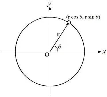

In addition to all the above extremely well written answers, especially by David Z and Ted Bunn, let me tell you how you can visualize the origin of the $rad/s$ in your dimensions for $\omega_0$.
First, we note that a simple harmonic motion is similar to a uniform motion on a circle. To see how, we will work with a specialise case where the particle is pulled to a distance $r$ away from the mean position and released and we start our clock when it is passing through its mean position i.e. $x=0$ when $t=0$. Thus we get the equation of motion as $x=r sin(\omega t)$.
Next we draw a circle with radius $r$ and centre at the origin, and place the particle at $(r,0)$. We then let the particle move at a constant angular velocity $\omega$.
circular motion
If we now look at the parametric coordinates of the particle when it is at an angle $\theta$ from the X-axis, we get its current position. Concentrating on only the Y-coordinate, we see that it corresponds to $y=r sin\theta$, or in terms of $\omega$, we have $y=r sin(\omega t)$. Hmm... looks almost like the equation of the second paragraph. Infact, if we look at another particle that can only move along the Y-axis and coupled to this particle, it actually does the exact simple harmonic motion we had with our spring system. Thus, uniform circular motion is exactly analogous to simple harmonic motion, and applying this analogy to our equations, we see that $\omega$ can be defined as the angular velocity of the particle and ths has dimensions of $rad/sec$ (since $\omega$ is by definition $d\theta/dt$).
But when doing physics, its actually better to have the arguments of the trigonomtric functions as dimensionless. Why? A look at the Taylor series of the $cos$ function might help :
$$cos(x)=1-x^2/2!+x^4/4!...$$
In the RHS, the first term $1$ is dimensionless. By the property of dimensional analysis, all additive terms must be of the same dimensions and thus have to be dimensionless. Thus, $x$ has to be dimensionless, and it is the argument of the cosine function. Hence, the requirement.
PS: There was a time when physicists actually let the angular frequency $\omega$ have the dimensions of $rad/sec$, to differentiate it from normal frequency $\nu$ or $f$ with a dimension of $1/sec$. But, nowadays its more natural to use $\omega$ for all frequency purposes because it fits more naturally into quantum mechanics, fourier transforms, special relativity etc.
