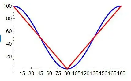

Below is a plot of the QM prediction (blue) and the local realistic model (red) correlations (y axis) versus the difference in angle between the two polarising analysers (x axis):
The quantum prediction for the correlation is equivalent to a single particle having passed through both the polarisers of the observers in the positions they are at, at the exact time the particles are received and is numerically equivalent to the equation for Malus Law ($\cos^2(\Delta \theta)$) which predicts the amount of light that is transmitted trough two successive polarisers with an angle of $\Delta \theta$ between them. Since Malus Law can be represented as ($\cos^2(|A-B|)$) where A in the the Angle of Alice's polariser and B is the angle of Bob's polariser, the local realistic model has the impossible task of predicting the outcome of that equation without knowing both A and B.
The implication is that each particle somehow 'knows' the position of the other polariser at the time the other particle passed though it, even though they may be separated in such a way that there is not enough time for any signal travelling at the speed of light to communicate that position. This implies non local interaction.
Bell's Theorem basically shows that any theory that relies on pre-coded information (however well hidden) and/or information passing that is limited to the speed of light, can not match the predictions of Quantum Mechanics and this is confirmed by the results of real experiments.
