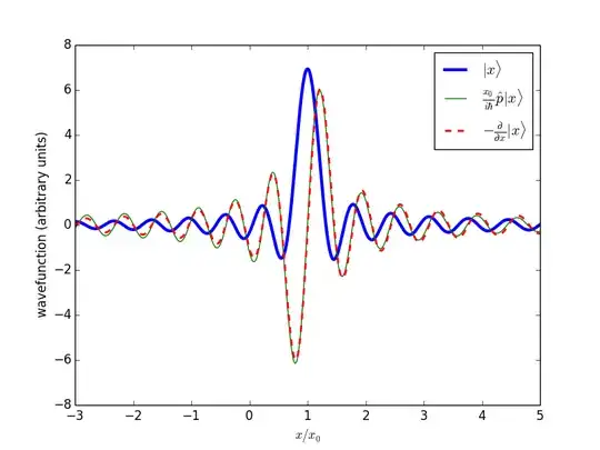

approximate position eigenstate and derivatives
To connect a little better with your question about modeling, here's a plot of an approximation to a position eigenstate $\left|x=x_0\right>$ truncated at $\left|n=50\right>$, along with the same approximation for $\hat p\left|x\right>$ and a numerical derivative. You can sort of see how $\left|x\right>$ will tend towards a $\delta$ function as terms with higher $\left|n\right>$ are included, and in what sense the shape of $\hat p\left|x\right>$ will tend towards $-\delta'$.
