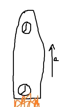

The picture shows an accelerating spaceship with two clocks inside it. It is so far away from all other bodys that gravity is of no importance.
Will the bottommost clock be slower than the topmost one? Or will both clocks have the same speed?
The bottom clock will run slower than the top clock.
The simple way to explain this is to appeal to the equivalence principle. This tells us that locally an acceleration is equivalent to a gravitational field. So if the rocket is accelerating at some acceleration $a$ this is equivalent to two clocks sitting stationary in a gravitational acceleration $a$.
We can use this to calculate the gravitational time dilation between the clocks because to a first approximation the relative time dilation is given by:
$$ \frac{\Delta t_{top}}{\Delta t_{bottom}} = \frac{1}{\sqrt{ 1 + \frac{2 \Delta\Phi}{c^2}}} $$
where $\Delta t_{top}$ is the time interval measured by the top clock, $\Delta t_{bottom}$ is the time interval measured by the bottom clock and $\Delta\Phi$ is the difference in the Newtonian gravitational potential. If the distance between the clocks is $h$, then the difference in the potential is simply:
$$ \Delta\Phi = ah $$
so:
$$ \frac{\Delta t_{top}}{\Delta t_{bottom}} = \frac{1}{\sqrt{ 1 + \frac{2ah}{c^2}}} $$
Let's do this calculation for an acceleration of $1g$ and a rocket length of $100$ m. We're taking the upward direction as positive, which means the acceleration is negative because it points down. The relative time is:
$$\begin{align} \frac{\Delta t_{top}}{\Delta t_{bottom}} &= \frac{1}{\sqrt{ 1 + \frac{2 \times -9.81 \times 100}{c^2}}} \\ &= 1.00000000000001 \end{align}$$
The ratio is possibly better written as $1 + 10^{-14}$ i.e. there are thirteen zeros after the decimal point. This is an extraordinarily small effect, but it can be measured. Indeed it was measured by the Pound-Rebka experiment.

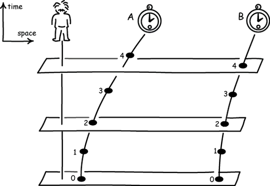

As usual, a spacetime diagram is helpful:
Plotted are portions of the worldlines of two clocks with uniform proper acceleration to the right.
When the coordinate time is zero, both clocks are (momentarily) at rest in this frame and both clocks are (momentarily) synchronized with the coordinate time, i.e, both accelerated clocks read zero when the coordinate time is zero.
Now, according to either clock, the distance between the two clocks is constant (both clocks have constant Rindler spatial coordinate).
But, the accelerometer on clock A measures a greater acceleration than the accelerometer on clock B. This is clearly evident given that the curvature of clock A's worldline is greater.
And, indeed, we see that clock A is running more slowly than clock B.
