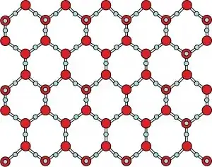

Water is known as $H_2O$. In it's liquid state this molecules wiggles around and needs more space.
Hexagonal lattice structure
Cooling water down slows this wiggling motion. After the phase transition to it's solid phase it is called ice. The solid phase features a hexagonal lattice structure caused by strong hydrogen bonds. The picture depicts red oxygen and small gray hydrogen atoms. Due to the compact lattice density of water ice is less than it's fluid phase. Concluding icebergs and ice in your drink can float in water.
