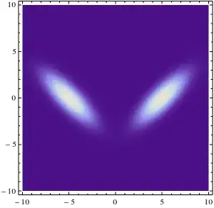

This is what I get for particle density in $(x,y)$ space — evaluated as in $(1)$:

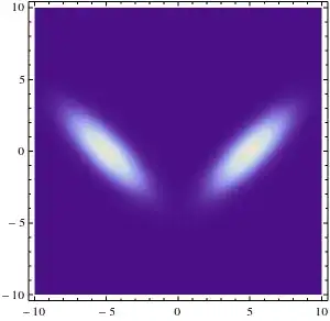

And this is what I'd expect based on the answers to the question mentioned above (this was generated as a probability density for single particle in two-packets state):
