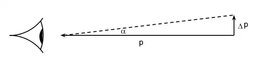

Because there is an uncertainty in the momentum there is an uncertainty in the angle from which the photon came. To see this look at the following diagram:
Radio wave
The uncertainty in momentum produces an uncertainty in the angle of $\alpha$ given by:
$$ \tan\alpha = \frac{\Delta p}{p} $$
If we substitute our expression above for $\Delta p$ and use the expression for the momentum of a photon, $p = h/\lambda$, we get:
$$ \tan\alpha = \frac{\lambda}{d} \tag{1} $$
And that's why if you want good resolution you need a large dish, and why large wavelengths give poorer resolution than short wavelengths.
