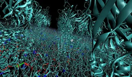

Some interesting large simulations to date was of the protein factory, the ribosome, probably the evolutionary oldest complex part of life, and of a complete virus, the Satellite Tobacco Mosaic Virus. Below is a snapshot of a simulation I did of ion-channels in a cell membrane, you see a drug molecule bound in white in the center: forest of ion channels
