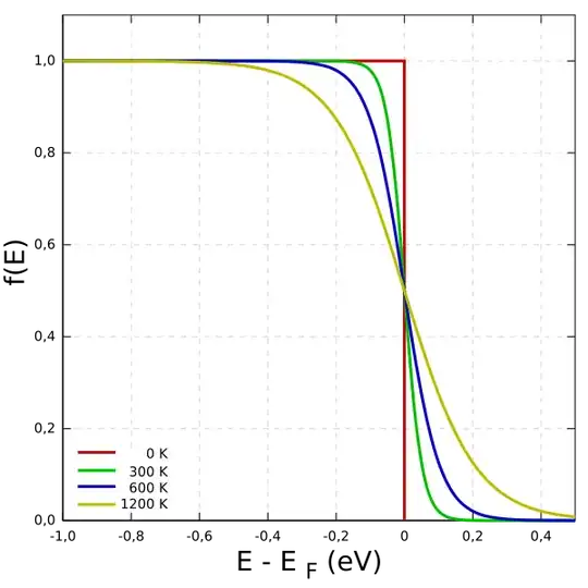

First you must know that only electrons with an energy close to the Fermi energy can participate to the conduction process. Why? I mentioned earlier that at $T = 0$, the Fermi energy is a sharp line. At $T > 0$, this sharp line gets “washed out” and you get something like this:
$\hspace{1.8in}$
This means that instead of only full and empty states, you now have half empty states above and below the Fermi energy. This is turn means that you are now able to excite electrons in higher energy states, which you need to do if you want to accelerate them in a direction; i.e., if you want to do work on them.

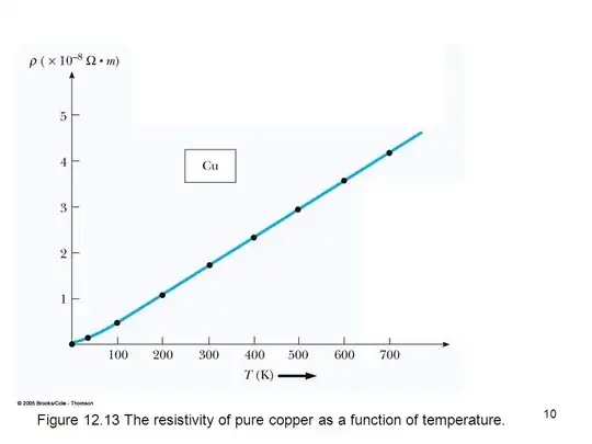

Then NoEigenvalue's answer claims, "First you must know that only electrons with an energy close to the Fermi energy can participate to the conduction process...At $T>0$...you are [only] now able to excite electrons in higher energy states, which you need to do if you want to accelerate them in a direction; i.e., if you want to do work [i.e, produce current] on them." (emphasis supplied) This argument is not explained. It is actually backwards as well. I debunked this misconception here. It is obviously false when you consider either of these metals at low temperatures, where according to the argument there would be no electrons to carry current, and conduction would be zero. In reality this is where conduction is maximized and resistivity (the inverse) approaches a minimum:
Pure copper actually has almost no resistance at <span class=$T=0K$" />
