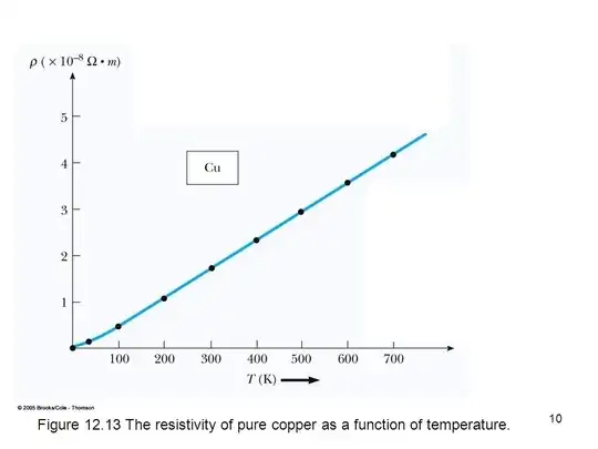

Incidentally, once a conduction band in a semiconductor becomes populated, further increases in temperature should decrease conductivity and increase resistance as phonons can interact more strongly with the free electron cloud.
In my air hockey example, the free, conducting pucks become small enough to have to slide without an air layer. Therefore, even in semiconductors more electrons being above the Fermi level does not always correlate to lower resistances or more current flow.
