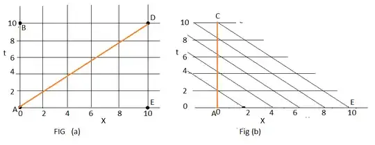

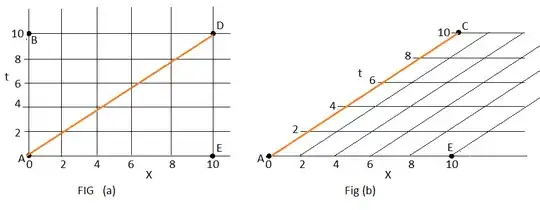

Q2. Suppose there are two objects (see fig), an apple A above the earth at x=0, and the earth E at x=10 as shown in the fig. If there is no earth and just the apple in open space, then the spacetime is not curved due to the gravity of the earth, and the apple stays at x=0 but moves in time from A to B (fig a). Now the earth is at x=10 and presumably the spacetime curves and the axes tilt as in fig b. Then the apple moves from A to C, just following the geodesic. But if we assume this, then the apple has not moved at all, because, due to the tilt of the axis, point C is also at x=0. So fig b cannot be the correct situation, otherwise the apple will arrive at point C which is still on the x=0 axis. So I assume that in fact the apple has not moved from A to C in fig b, but has moved from A to D in fig. a, where D is really at x=10. But if I assume this, then it is not spacetime itself that has curved. The spacetime is still straight, but the apple has moved from (x=0,t=0) to (x=10,t=10). Again, where am I wrong, and what is the correct explanation? How exactly has the spacetime curved or tilted for the apple at A due to the presence of the Earth at E, and how does the apple move to the earth by following the geodesic in free fall? (assume only one spatial dimention)

Re (2): your drawing isn't a good description of the spacetime near a spherically symmetric object like the Earth. In these circumstances the curvature is given by the Schwarzschild metric. Calculating the trajectory of your apple in this metric is far from trivial. As it happens this issue is addressed on the recent question Naive visualization of space-time curvature. Sadly, the answer to this question is that there is no reliable naive visualisation of spacetime curvature. The only way to calculate the trajectory is to bite the bullet and use the geodesic equation.

Since no one has answered the second question, and since I discovered the answer subsequently, so I will post it. I only hope that it is correct. The spacetime bends backwards, so that if the the apple takes the shortest path, ie vertical, it reaches the point C where x=10 (in fig b) due to the backward tilt of the axis. Actually, these lines are curves to allow for parabolic nature of acceleration. I have drawn them as straight lines, just to show approximately which way they will bend. Remember, the apple started out at A, where x=0, and the earth was at x=10. Compare with the fig in the question which did not make sense due to the tilt of the axes in the wrong direction.
The vertical line followed by the apple in fig b shows that the apple thinks that it is at rest and the earth is accelerating towards it.
Spacetime is not "tilted", like you show it, because the two dimension must be orthogonal everywhere. This is shown here:
http://www.youtube.com/watch?v=DdC0QN6f3G4
