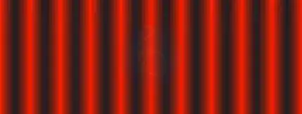

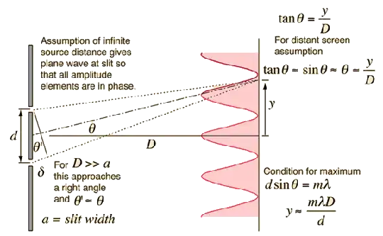

Double slit interference pattern looks as shown below:
When you see the same patter at different angle you will see it as shown below: enter image description here
Believing that your text book is correct in saying that fringe separation as the distance between the centers of adjacent bright or dark fringes (in double slit experiment) from the center of the screen, my textbook defines fringe width as the same (by the formula of fringe width). So, I think fringe width is nothing but fringe separation.
I think you are facing difficulty in understanding how dark fringe could have width seeing the second image above. I hope you are understanding bright fringe width. The dark fringe width can be assumed to be distance between upper points of the two consecutive crest like shapes (see the below figure, it is the wave, but you can imagine it to be interference pattern), it mean the same as saying distance between the centers of two consecutive bright or dark fringe.

It is fringe width ,the distance between centers of adjacent secondary maxima's or minima's and it is $\lambda d/D$.This is what question expects from you here to use.But instead I think you are confused because actual width of fringe looks only half of above.But note it is varying intensity of light there so you choose only lines as fringe centers and just calculate distance between them to have fringe width.Just read this carefully to understand I neither explained it in detail nor explained it as good as I can.
