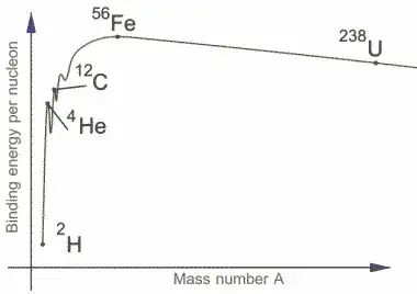

Energy diagram

I am an A-Level physics student. While revising I had the same question and after reading the other answers and lots of thinking I´ve come to a conclusion. Probably you as I did are thinking that binding energy is the energy used to sustain the bonds in a nucleus but it is not. Rather binding energy is an indicator of how efficient the bonds within a nucleus are, as there can be really strong bonds that require little energy. Atoms with a higher binding energy are more stable and therefore require less energy to form, allowing them to emit it. This is very well shown by the graph posted by @John Rennie.
For example, when Uranium-235 undergoes fission into Barium and Krypton, the products have a higher binding energy that the initial Uranium because they are more stable and require less energy to form, so they emit that difference in binding energy. The mass deficit is not used in building stronger bonds as it is essentially released because the bonds need less energy. Rather the mass deficit is simply a consequence of releasing the difference in binding energy.
This efficiency I am talking about has to do with how the atom is structured. As seen in the graph from hydrogen up to iron the binding energy per nucleon increases because you can fit protons and neutrons in a very compact manner which makes the strong nuclear force to increase faster than the electrostatic repulsion. However, in elements with a higher mass number than iron the electromagnetic force will begin to take over as the nucleus becomes too big for the strong force to be effective, thus reducing their binding energy (Fun fact: In heavy elements atoms have more neutrons than protons because this helps increase the distance between them, thus reducing the electrostatic repulsion). This results in many elements with a higher mass number than iron being radioactive because they are unstable and seek a better configuration. This is very well explained in this video: https://www.youtube.com/watch?v=mpDDQ4uEH6M
