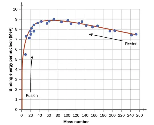

Binding energy is a measure of how tightly the nucleons (electrons for chemical reaction) are bound in a nucleus (atom/molecule). Specifically, it is the sum of the masses of the individual nucleons minus the mass of the nucleus consisting of those nucleons. For an exothermic reaction, the binding energy of the reactants is less than the binding energy of the products; that is the nucleons for the products are more tightly bound (more binding energy) than those for the reactants. For example, in a nuclear fission or fusion reaction, we "moveup" the curve of binding energy, as indicated in the following curve.
Binding energy is just another way to address the change of mass (rest mass) to kinetic energy.
