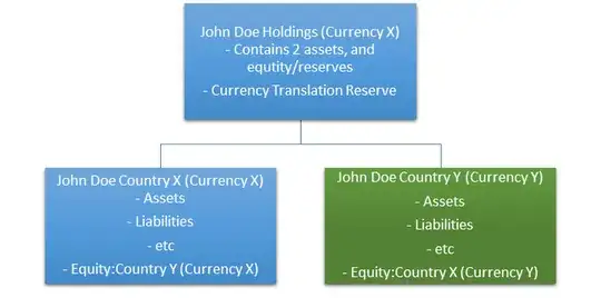

If you spend 51% time in Country X and 49% in Country Y, the most ideal way is to create separate books, with a holding entity, and use inter-company accounts for transfers.

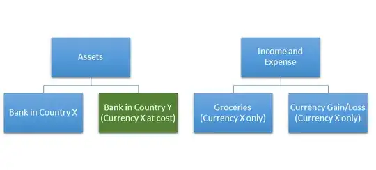

If your income source is highly concentrated in Country X, and you only spend time in Country Y occasionally, the correct way is to use Currency X for everything, but treat your Foreign Currency in Bank as Inventory. When you purchase Currency Y with Currency X, you record double entry in Currency X, but note down the cost.
Pic2
When you spend your Currency Y, credit that Foreign Bank at cost (in Currency X), debit expense at market value (still in Currency X), put difference in Currency Gain.
You have to decide between First in First Out and Weighted Average method to measure the cost.
