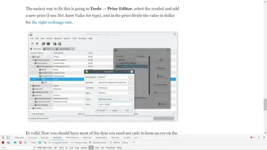

Then use the price editor for each foreign account:
gnucash editor
