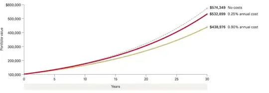

Should you care? From Vanguard:
The long-term impact of investment costs on portfolio balances Assuming a starting balance of $100,000 and a yearly return of 6%, which is reinvested
Check out this chart, reflecting the impact of relatively small expense ratios on your 30 year return:
All else being equal you should very much care about expense ratios. You end up with a significantly smaller amount if your pre-expense return is the same. A 0.75% difference in ER compounds to 20% over 30 years.
