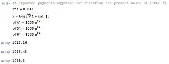

I've gone through the steps first with small numbers:-
Planning to retire in 4 months and draw monthly income of £1000 (present value) for 3 months, adjusted for inflation. APR is 8% and inflation is 4%. What should the pot be?

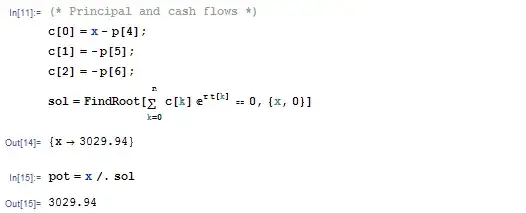

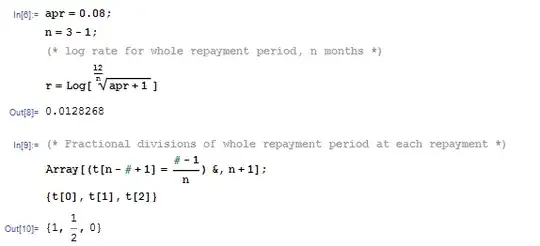

Therefore need a pot at month 4 that can deliver these payment at months 4, 5 & 6 with APR = 8%
So for the root calculation t[0] is 1, t[1] is 0.5 and t[2] is 0.
Ref: http://en.wikipedia.org/wiki/Rate_of_return#Internal_rate_of_return

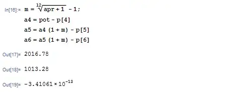

Checking: amounts remaining in the pot after month n, using monthly rate m
Pot is empty after month 6, so everything seems to work.

After reviewing this calculation, it can be done more simply:-
inf = 0.04;
i = (1 + inf)^(1/12) - 1
0.00327374
apr = 0.08;
m = (1 + apr)^(1/12) - 1
0.00643403
calc = Function[n, 1000 (1 + i)^n (1 + m)^-(n - 4)];
discountedpayouts = Map[calc, {4, 5, 6}]
{1013.16, 1009.98, 1006.81}
pensionpot = Total[discountedpayouts]
3029.94

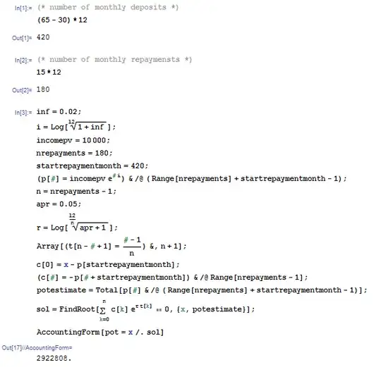

Now running a generalised version with £10,000 (present value) payouts with inflation at 2% and APR 5%, as specified by the OP.
This finds a pot requirement of £2,922,808 which is a little different to the OP's result, most likely due to the difference between the US and EU formulations of APR and compounding methods.
Switching inflation and APR to 0% yields £1,800,000.
Inflation at 2% and APR at 0% yields £4,188,098.
Inflation at 0% and APR at 5% yields £1,279,041.
