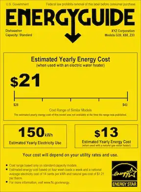

For the past few decades, US law has required water heaters and other major appliances to ship with a big yellow "Energyguide" label which shows estimated annual energy cost. If somebody didn't take it off, this is the best place to start.
If it's old or your power is very expensive (e.g. California), the energy prices may be different from what you're paying now, so look for the kWh figure and multiply it by your current rate from your power bill.
If the label is missing, you may try to contact the manufacturer to see if they have this data accessible.
Energyguide Label
(US Government image)
