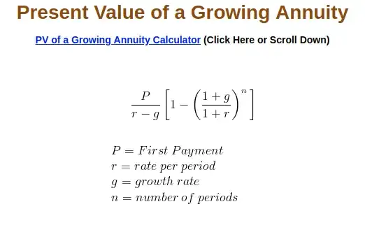

Is this the right equation? From what I could find on Google, this calculation is called the present value of a growing or graduated annuity. Is this correct?
