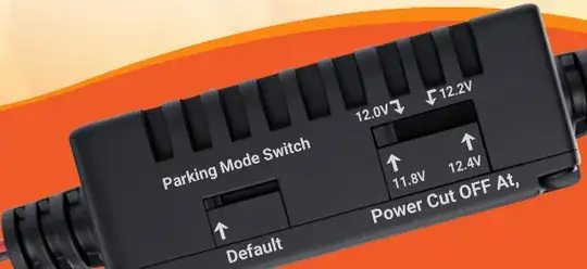

Question 2: Low Voltage Protection
The hardwire kit includes low voltage protection, and I plan to set it to the highest threshold (12.4V) to avoid draining the battery.
  • My plan:
    • Use Parking Guard mode when the car is parked.
    • Switch to normal mode when driving.
Is there anything I’m missing or should be cautious about here?
