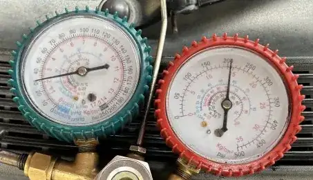

30+psi/low side seems a little lower than ideal, 200+psi/hi side appears higher than normal. Does the cooling fan run or not? The cooling fan always runs when ac is running. A dead or slow running (worn out) cooling fan will allow discharge/high side pressures to increase to dangerous levels when the combination low/high pressure sensor detects out of range values and sends a disable signal to the ecm. The ecm disables compressor power until pressures subside; system pressures equalize - high pressures lower, low pressures rise until the high side pressures drop to safe operating pressure when the pressure sensor detects it and sends a signal to the ecm to enable power to the compressor.
Open the engine hood with engine idling, ac off. On a warm day, the cooling fan may run or not, depending on engine coolant temperatures. Pressurized cooling systems run as hot as 220F/104C when the cooling fan turns on and turns off when coolant temps drop below approximately 210F/99C.When ac is turned on, the cooling fan turns on immediately to force airflow thru ac condenser coil and hot radiator to prevent ac pressures from rising above a certain pressure, and coolant from overheating. If the cooling fan runs at low speed when ac is turned on, it may be worn out. On very hot days, the two speed cooling fan should alternate between low and high speed with ac running. On hot days with ac on, in stop and go traffic, the fan should be running at high speed. enter image description here
